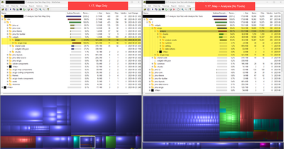

The size of an Experience Builder 1.17 app ballons when including the Analysis Widget
493
08-25-2025 10:05 AM
RyanTaylor
When adding the analysis widget to an Experience Builder 1.17 application, even if not adding any tools analysis, the size of the app balloons by > 150 MB.
It seems a lot of node files are being included in the output. It's unclear if this is necessary or not, but considering I hadn't added any tools, their inclusion is suspect.

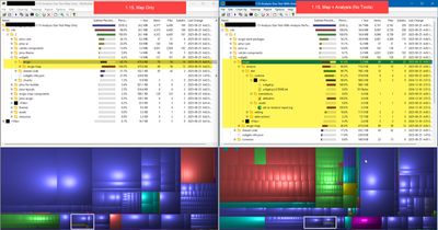

This does not appear to happen in Experience Builder 1.15.
Colleagues say this does not happen at 1.16 as well, though, I do not have screenshots for that.
Is this behavior expected?
