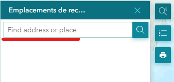

After add "?locale=fr" to URL, the placeholder for Search Tool of map widget is still "Find address or place" and doesn't change to French like the header.
Is there any place to change?

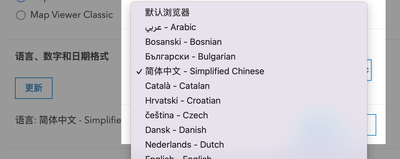

@Ming Using URL can change locale inside the Experience Builder app, however, this search tool content is inherited from the AGOL map so it will not be affected by app-level URL parameters.
If you want to modify the locale of this specific placeholder, changing your user profile language will do the trick:

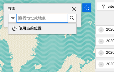

Thank you very much @TonghuiMing Changing the map owner user profile language works!

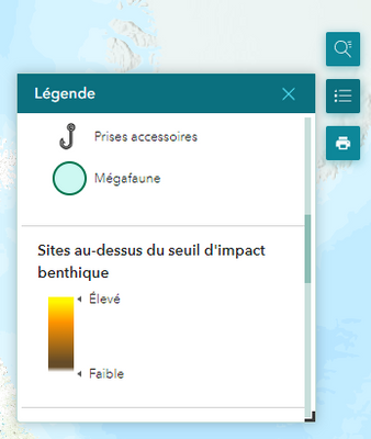

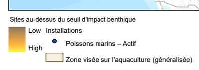

 For French version, the Low/High in printed legend is not translated into French:
Although the heat map legend in the map has been translated to French by changing the map owner's profile and set its default language to French:

Hi @Ming - this is not an issue from Experience Builder, but rather from the printing service or AGOL - and Tanu is the right person to follow up with. I suggest you follow his instructions on the other chat and continue to work it out, hopefully soon. Thanks.
Ming
Thanks @TonghuiMing , confirmed that it is a bug and here is the detail:
BUG-000152950: When printing a web map with a legend using heat map symbology in Map Viewer, the language of the legend is English even when the owner's language preference is set to French.
