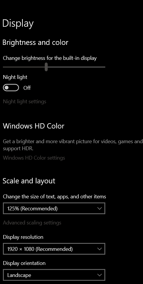

Hey everyone, the issue I am having is my text and buttons that I have added to the header do not scale with different resolutions on different monitors and laptops. When I say resolutions I am referring to the Scale and layout settings under display settings on Windows. See below:

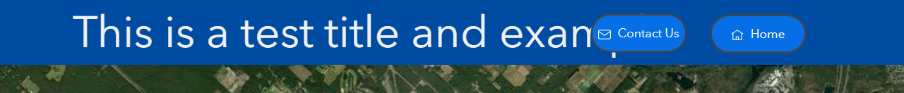

On my laptop screen the scale and layout setting is at 125% and when I view my published experience this happens.
However if I set my scale back to 100% it will display correctly, I have a widget controller as well with three widgets and it only displays two on 125%.

Thanks for your feedback. From my understanding, you see overlaps of text and buttons in ExB when change the scree resolution, right?
Here are my suggestion:
Try to align the text widget and button widgets to the same side. I guess you are aligning the text to the left, while button to the right. They are using % unit for size and alignment. So when the resolution changes, their positions change as well. But since they are not aligned to the same side, they are not aligning in the same manner, so overlap can happen, and that's as expected. To avoid overlap, align them to the same side, make sure they use the same unit (say %) for alignment.

BrandonMcAlister
Hi Wei,
I have tried that and the buttons still overlap with text and when changing into different resolutions are no longer snapped to the edge. Also the text doesn't scale appropriately with different resolutions. Maybe I am misunderstanding how it works or is there a way to set the size of the text to scale to the size of the container?
