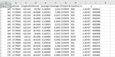

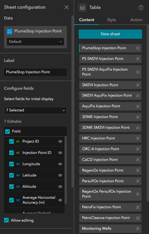

I have selected the appropriate fields I want to be displayed in my export table within my sheet in Experience Builder. I reordered them within the sheet in hopes that they would carry over this order when exporting into a csv. This is not the case. Is there a tip to keep the same order within the sheet and have it transfer the same order to the csv? Below are two snips.

Hello everyone, sorry for the late response. This one fell into the cracks until @LJackson29's comment reminded me. Unfortunately, this issue has not been addressed due to the createReplica method used when exporting the data, but I think there may be a workaround.
For selected records, ExB uses queries to fetch the data and export it. When using queries, the field order can be properly respected. However, for exporting all data, considering the performance issues with large datasets, ExB always uses createReplica, which is a server-side API, and it's more reliable and efficient. The downside of it is that it doesn't honour the original field order.
A possible walkaround is to disable createReplica for the data. To do that, you need to disable both Export and Sync capabilities when publishing the service. This walkaround should work for anonymous and general users, but not for data owners and organisation administrators (they have the full editing/export privileges even if those capabilities are turned off). Please note, as I mentioned above, it may raise performance issues when manipulating large datasets.

I tried your proposed workaround with help from Amir on the ESRI support team, but to no avail. I was able to turn off Export and Sync capabilities on the settings for the Hosted Feature Layer, but turning off Export also disables exporting in Experience Builder, and so my users no longer have the option to export to CSV.
Am I missing something?
