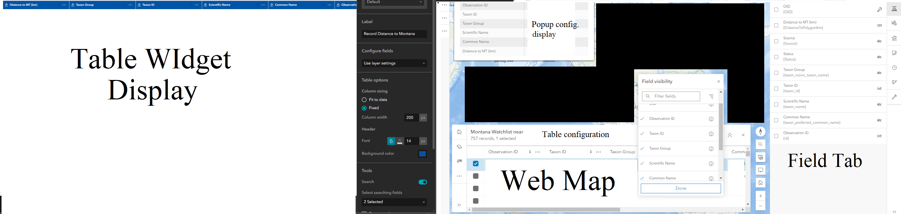

I have multiple tables I am trying to display with the table widget. When I set Configure fields to customize I am able to rearrange and display the fields as desired. However, when this option is selected, the column do not respect the feature layer configurations setup. For example, I do not want to display comma separators for ID and a Year field, but commas are displayed; I have a decimal field to display only a single digit, but an infinite number is displayed after the decimal.
When I set the widgets Configure fields to "Use layer setting", my layers configurations are honored, however the columns are rearranged in a no meaningful order that I am unable to change. I have configured the popups to display the columns in the appropriate order but the widget does not honor this. The widget is not even following the order the columns are in for the initial feature table. The order the widget appears to be following follows that of the tables within the web map, when you click on the "Fields" tab. Again though this order is unchangeable, does not follow the popups configuration nor the tables initial column structure

I was able to fix this by modifying the JSON for the web map using AGOL Assistant. Why it is brought into the web map in a random order, is still a mystery.

Hello, having the same issue, how exectly did you modify the JSON to solve this...?
Kyle_Kaskie
@DanLeština I was able to make the modification through the AGOL Assistant .   I was able to reorder the fields to display appropriately.
