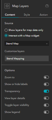

@Shen_Zhang- I also see when you enable Layer widget you get the option now to 'View table', however, when I click to 'View table' nothing happens. Also, nothing happens when I click 'Export all'. It shows up the different formats I can export to, but when I click it nothing happens.  Only, the transparency toggle works. Please see screen shots below of the configuration below.
Configuration
Action
Upon clicking the ellipses of the layer (...)
Thank you,
Abi
Shen_Zhang
In the second paragraph of my previous post, I was trying to explain how to use Set filter data action to do runtime queries. The set filter works on the layer itself, meaning all the widgets using this layer will be filtered. For example, you have a layer in the Map layers widget and want to add it to the table and add some queries. First, you can add it to the table to see the attributes of the layer. Then you could use the Set filter data action from either the Map layers widget or the Table widget to add runtime queries.
For the issue regarding the Map layers widget, could you share a simple app with me to investigate?
