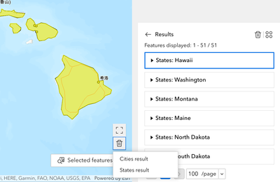

3) In addition, there should be an option to reset the yellow fill "Show in Map" option after the query is run. There is no way to get rid of the yellow fill without refreshing the app entirely, which is not ideal. This question was submitted over 1.5 years ago and had not been addressed.

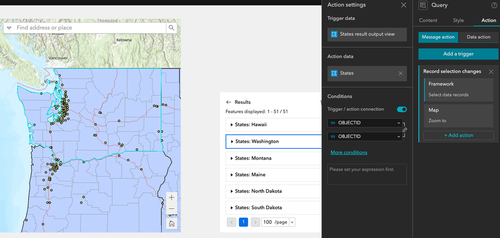

For #2, highlights from query is the output data source generated from query, which is different from the original datasource. If selection of the original feature records are needed, you'll need to set the Framework level message action:
Framework > Select data records > Trigger from query output to the original layer > bind by fields:
Then you'll get the desired behavior.
See more details in https://doc.arcgis.com/en/experience-builder/latest/configure-widgets/action-triggers.htm
For #3, show on map results can be removed from the map. After results are populated, the trash bin icon will list all the results shown so they can be deleted, and they will not be affected by removing the original widget
