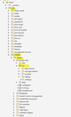

I'm trying to develop a custom widget that has the functionality of the Lists widget in a tab.
Is there a way to bring in a basic widget as a component in your custom widget?
If that's not possible where can I find the source code for the basic widgets, so I can replicate the functionality?
Grant-S-Carroll
Hi @MichaelWen_Timmons  have you looked at the sample code in the GitHub repo which shows wrapping OOTB JSAPI widgets in to an Experience Builder widget?
https://github.com/Esri/arcgis-experience-builder-sdk-resources/tree/master/widgets/js-api-widget
If you are looking for the source code for the OOTB widgets in ExB, they can be found as per the pic below
MichaelWen_Timmons
Thank you very much. I didn't realize I already have it.
