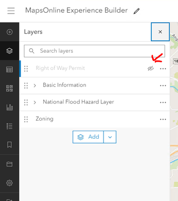

Many of the map customization options in Experience Builder are handled indirectly through the Web Map Viewer. This is one of those. In the Layer List of the webmap, turn off the visibility of the layer and your choice will be respected by Experience Builder. In ArcGIS Online, you will need to hover over the layer you want to turn off and click the eye that appears. (This will look a little different in ArcGIS Enterprise.)

Experience Builder should honor the layer visibility of your web map, so if you turn off layers B and C in your web map and save it, you should only see layer A next time you reload the Experience Builder app. Then if you've enabled the layer list for the map (toggle on "Layers" under Tools in the map settings in EB), you and your users can use that to turn layers on and off if desired.

That does the trick, thanks!

That works, thanks!
