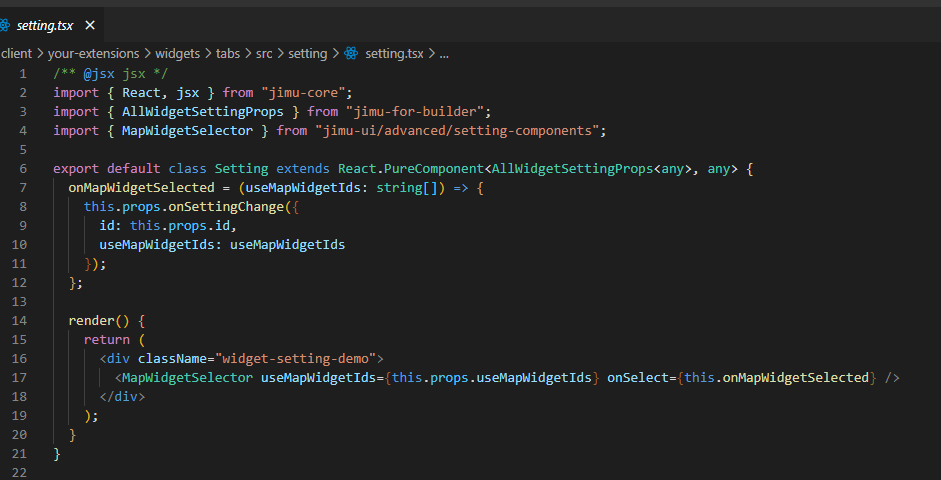

I am currently developing a custom widget for the experience builder and I followed the steps outlined at:
to setup the settings page on my widget.

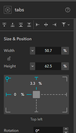

Even though the settings page in my custom widget is identical to the one used on the Add Layer tutorial, I am not able to select a map view data source when I click on my custom widget ExB.
Suggestions?
"Select Map Widget" is missing from the widget.
Junshan_Liu
Can you check whether you set the "hasSettingPage: false" in the widget manifest.json?
