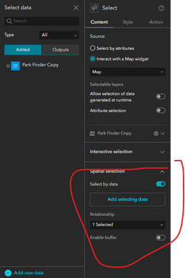

Ooooh, you are talking about this option.
Yeah, that's not going to work with a runtime added layer.
