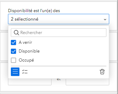

When i select my elements, i have this :

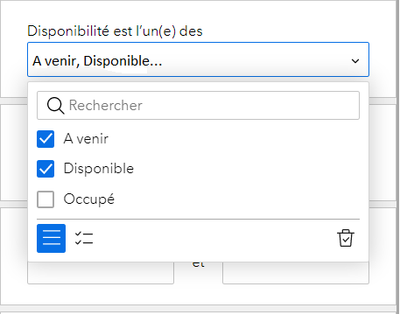

It's possible to see :
instead of the "2 sélectionné" text ?

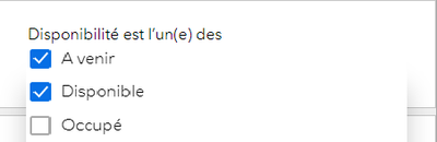

And other question : it is possible to use the filter widget directly with the checkbox without using the dropdown list ?
Something like this :
I know it's possible to use a button instead of the list choice, but the button solution is not very efficient when i have 5 or more choice in my filter widget, that created a large framework for the current filter widget and it's not esthetic.

TonghuiMing
Hi @JasonBOCQUET
For your first question, the short answer is no, if you are using the OOTB functions. Showing all the labels might raise UI/I18N issues and not the current design.
For your second question, we have that in mind but there is no way for that at this moment.
Hope that answers some of your concerns. If you feel like that these are helpful, you can also post them in the Ideas channel and we will be watching & evaluating the requests based on feedback. Thanks.

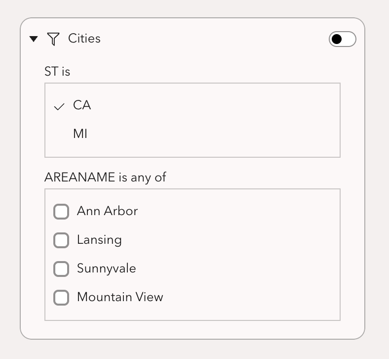

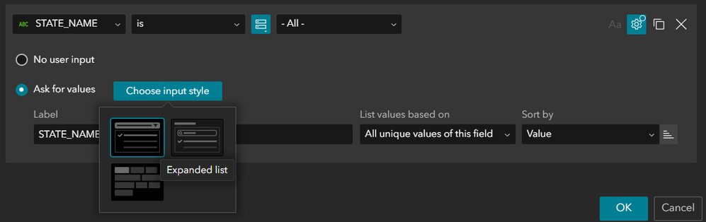

@JasonBOCQUET In the latest AGOL Oct release, Filter (SQL Expression Builder) now supports the "Expanded list" input style, and you can configure it like this:
TonghuiMing_0-1761282952997.pngTonghuiMing_0-1761282952997.pngTonghuiMing_1-1761282960973.pngTonghuiMing_1-1761282960973.png
