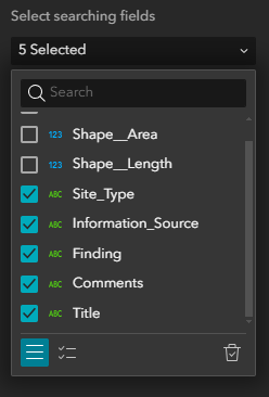

I'm using the Search widget for two feature layers in an Experience Builder application. As shown below, I'm searching within 5 fields for this particular feature layer. I can get search results without pressing Enter for some of the fields but for others I get "No search results" and have to press Enter to see the results. Why might this be the case? There are differences between them (e.g. max length, whether null values are allowed) but I can't imagine it's related to these differences.
Also, for all of the 5 fields, I get "No search results" for text that is not at the beginning of the string and have to press Enter to see the results. Is there a way to resolve this, even if this means removing all search results before pressing Enter?

Hi @COwen ,
Due to performance issues, different search methods are used to get search suggestions and search results. Search suggestions use "Start with" or full-text index, while search results use "Contain".
There is currently an issue in our repo to remove "no results" from search suggestions.

Hi @ShengdiZhang,
Thanks so much for your reply. That is very useful to know.
What would be your explanation for why some fields don't get search suggestions (using "Start with" or full-text index) while others do?
