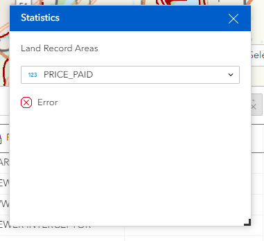

The "statistics" tool within the Table widget doesn't seem to be working - an error message shows up whenever the user selects a field.
This issue is occurring for multiple layers in different apps within our organization.
Any suggestions?
edit: this is in ArcGIS Enterprise 11.3

11.3 and using EGDBs I'm getting the exact same behaviour.
Hosted feature layers function as expected, but published feature classes referencing data on our SQL database throw an error in Experience Builder.  My initial suspicion was that it may have been caused by a desync in our EGDB versions but I observed the same error with features from EGDB versions 11.0.0.3.00, 10.9.2.8, and 11.2.049743.
Each failure shows up in the Server manager as "General geodatabase error occured."
Not a lot to go on, and no solution yet, but figured I'd throw my results into this thread in case it helps anyone narrow down the cause in the future.
I'll update this post if I figure anything out.
BramptonMaps
Were you ever able to figure this out.  We have determined that the outStatisticFieldName went from "value" in 10.9.1 to "arcgis_charts_outStatisticFieldName_default_key" in 11.5 and it's throwing an name length error.
