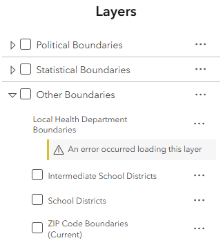

Here's the map layers widget I have next to the map--all normal, I get the warning that one of the layers is unavailable, but I can still make the other layers visible if I want to:

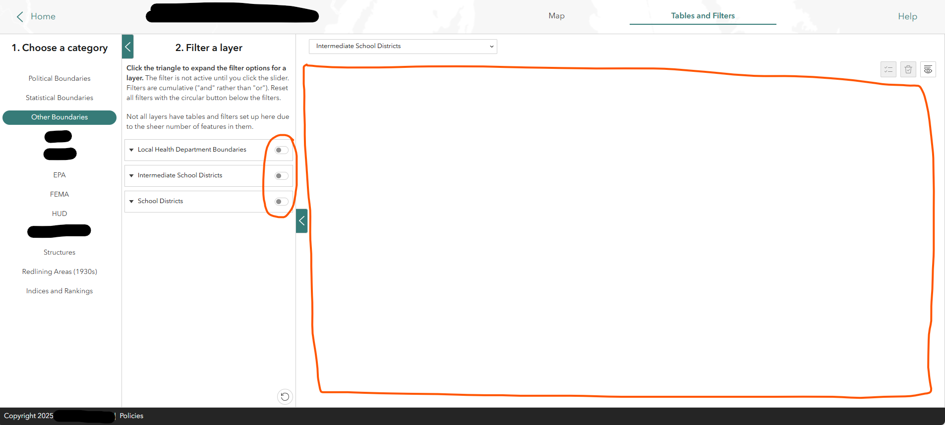

Despite the other layers in this group (Intermediate School Districts and School Districts (I don't have ZIP Codes as a filterable layer)) still being available, the entire filter widget gets grayed out, and the tables go white:

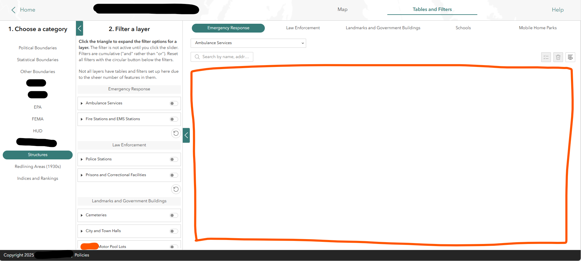

It also doesn't matter whether I create separate filter widgets. In this example, since all the layers here are part of a group layer (Structures), and because the single layer blocked out in orange is currently unavailable, all the other layers are also unavailable to filter or view their tables:
