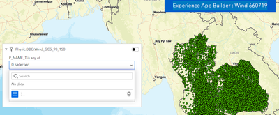

I switched from Web App Builder to Experience Builder to create a web map application, but I cannot use my favorite function: filter. The filter in Experience Builder does not show a dropdown menu. I have tried many methods, but the issue persists. Below are all the items I have used.

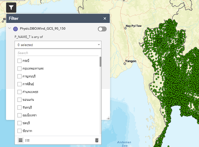

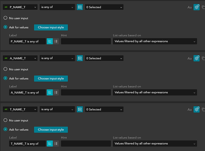

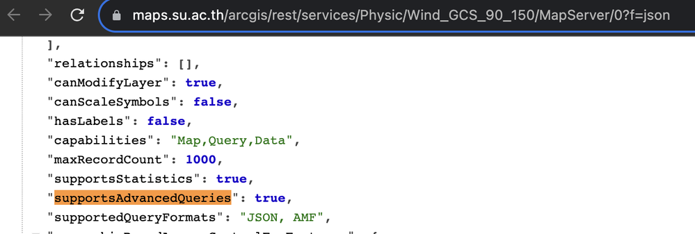

Per our preliminary investigation, the issue seems to be caused by this specific service.
It has the property supportsAdvancedQueries = 'true', but no advancedQueryCapabilities, which is needed to perform queries from ExB Filter. We think that's why it throws errors and cannot perform queries to get the expected results.
The dropdown list showing correctly in Web AppBuilder is probably because the logic in Experience Builder is different from that in WAB, and WAB did not pick up the abnormality.
