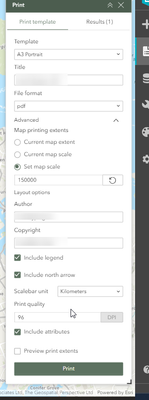

Hello, In the print widget I have the scalebar set to kilometers, but in the print widget output the scale bar shows both miles and km. Is it possible for just one measurement unit type to show?

If you are using the default print service, it is impossible to display only one unit in the scale bar because the print layout is predefined based on the setup style of the scale bar.
You can publish your own custom print service that includes a scale bar with only one unit.
