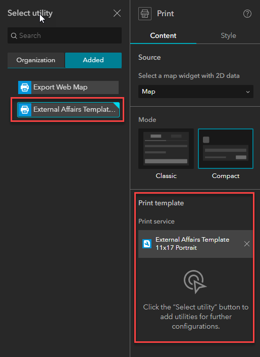

I'm having trouble get the print widget to work with EB. A custom layout service was created and published to our 10.8.1 enterprise - this document was used as my guide: https://enterprise.arcgis.com/en/server/10.8/create-web-apps/windows/tutorial-publish-additional-layouts-for-printing-with-arcgis-pro.htm

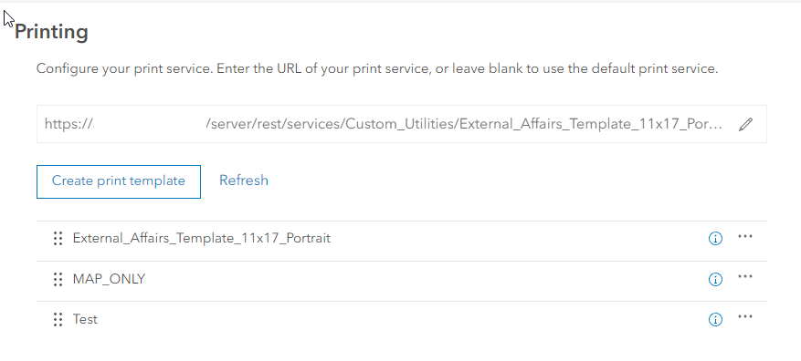

I can successfully add it into the printing utility service in AGOL and use the layout in the print widget within web appbuilder and in the print tab of web maps. When I add the same service URL into EB, the layout is not offered and neither are any test layouts.
From my understanding, I should see all layout options in that bottom right of the image above.
Here is a look at what I see in the print utility service section of AGOL (and which I expected to see reflected in the image from EB above):
I'm not sure if this is related but the URL I've generated does not have the ending "%20Task", it ends with "/Export%20Web%20Map" - does this matter?
The layout was published from ArcPro as synchronous.
I did get an error message during the Analyze portion of sharing the layout as a web tool that said, "00256 Server version 10.8.1 tool ExportWebMap_server parameter Format has changes to its datatype changed".
Grateful for any help!
