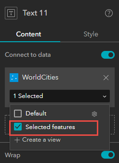

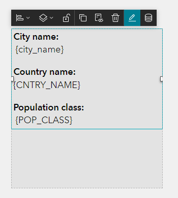

One way is to use the feature info widget, and disable the map widget pop-up from the map settings.
Another way is to use a text widget to display information about the selected feature.
Add a text widget, select data, and choose the view of the selected features. Then add dynamic content in the text widget.
Check the option "View for empty selection" to avoid displaying brackets when no feature is selected.
Here is how it looks at runtime:
