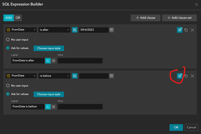

I'd also be interested to know if anyone has input on this. Trying to set up something like this now and having some trouble figuring out how to allow user input in Experience Builder.
MattBewleyDCGov
Specifically, and to @EricO 's question, I know message actions and the query widget can be used for allowing users to filter/select data, but haven't been able to figure out whether user-provided text or dates can be passed as filter conditions.
MattBewleyDCGov
I didn't realize that the settings in SQL Expression Builder allowed an "Ask for values" option like in Web AppBuilder. Oops! For me at least this seems to meet the need.
