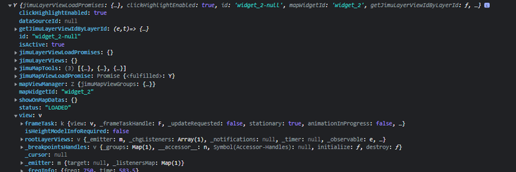

THank you. I followed the first method I am almost there.
In the child component, I console log the
and I get this:
I want to access the this.props.mapView.view which it is a property because under it is the map module.
However, when I console log
I get the red underline that the view is not a property of the mapView, however the console outputs the x coordinate. Why does it works? I was able to add a layer using the this.props.mapView.view.map.add
This is confusing. Thank you.
RobertScheitlin__GISP
MVP Emeritus
@LefterisKoumis looks like you are passing the jimuMapView to your component and not the jimuMapView.view. I use method one that Grant suggested in most of my custom components and pass the actual view object and don't have any problems.

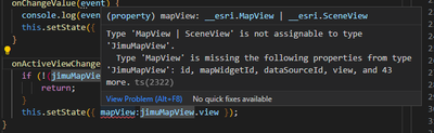

I got this error.
Question. Should we use the componentDidMount to update the jimuMapView state to avoid async  errors?
Grant-S-Carroll

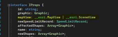

You just need to make sure that you have declared the mapView as the right type. Its not a jimuMapView you are assigning the view property of the jimuMapView, which can either be a MapView or a SceneView.
Component did mount will only fire once, when the component is mounted in to the DOM. At that stage, the map will most likely not have loaded, hence why using activeViewChange is the best place to capture when the map has loaded.
LefterisKoumis
Yes, you are correct. What a novice mistake. Thank you.
