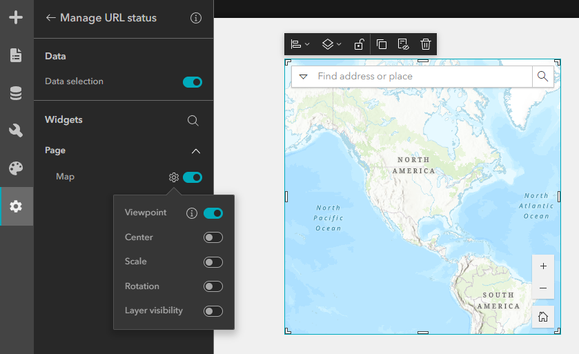

Shen_Zhang
This is supported in the AGOL June 2025 release. You can find the experience state option in Experience settings -> State & URL parameters.
