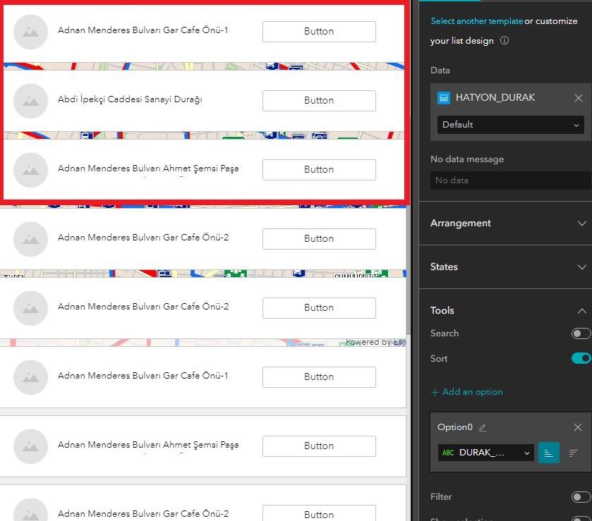

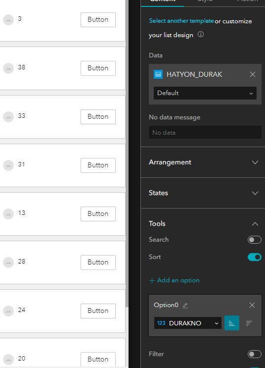

In List Widget, I want to sort with ascending numeric but list widget is not working ascending numeric order as you see in the first screenshot.
What am I doing wrong? or is there a bug about sorting in List Widget?

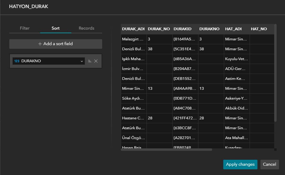

I am unable to reproduce your problem using the data view or the list sorting tool. Can you help to check if sorting on other non-numeric fields of this data or numeric fields of other data does not work as well?

I also checked sorting non-numeric fields as bus stop name field for the list widget. You can see the list sorting randomly for second character in the screenshot. I do not understand why this is happenning.
Is there any problems about relation between Portal for ArcGIS version and ArcGIS Experience Builder version? or configuration of Portal? I do not understand.

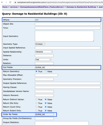

We did a quick test with some sample data and cannot reproduce the issue. From your description, my best guess would be that the service you are using may not support sorting. Could you please check the data service from your side? You can open the query html of your service and fill the highlighted inputs (see the attached screenshot as an example), then click "Query(GET)" button at the bottom to check whether the returned features are in the correct order.  Hope this info can help.
