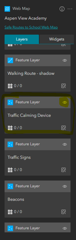

I used the data tab in Experience Builder to set those filters.  However, I needed to add a layer to an existing FeatureServer (from REST Services Directory).  I updated the underlying ArcGIS Pro project and republished the service.  The new layer appeared just fine in Map Viewer, but the new layer is not showing up in the app itself.
I have looked through each Web Map in the  Data tab, and the new layer is shown there.  I have tried 'hiding' and 'showing' the feature layer from within the Web Maps there , but that has no effect.
I have also gone into the Feature Layer settings from there, and turned on Auto Refresh.  I have additionally confirmed there are not any filters set.

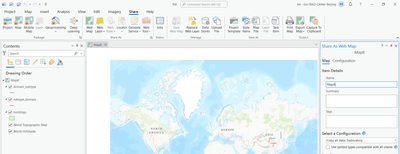

I updated the feature services using the following steps, but I don't see the new layer in the existing web map, so the new layer couldn't be seen in Exb. Could you describe your process in detail so we can reproduce the problem? Thanks.
1. Share a web map named MapA from ArcGIS Pro to AGOL or Portal.
2. Add a new layer to the exiting map of ArcGIS Pro and then overwrite the existing web layer.
3. Open the MapA in Map Viewer and found that new layer didn't update.
Thanks,
Ke
