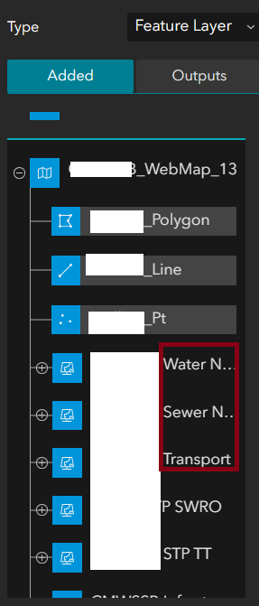

I have a near me widget in a webmap in experience builder, but it only displays some of the feature layers in the map. Does anyone know why this is happening.
This is What is displayed in Near me widgetThis is What is displayed in Near me widgetThe Layers in the red box which are part of the map is not getting displayed in near me.The Layers in the red box which are part of the map is not getting displayed in near me.
Can someone let me know if I am missing something?

Near Me only works with feature layers, so if they are not loaded as feature layers, that may be your issue.
It also appears that your missing layers are inside groups. What version of Experience Builder are you using? If I remember correctly, the first release of the Near Me Widget had a bug where it could not pick up feature layers that were part of a group.

The layers are added as feature layers and yes, they are inside a group.
The version of experience builder I am using is 1.13.0.
Is there anything else that needs to be looked into?
Thanks.
JeffreyThompson2
MVP Frequent Contributor
Try un-grouping the layers and see if they are picked up. If you can accept them un-grouped, then you have a solution. If not, try upgrading to 1.14. The bug should be fixed by now.
