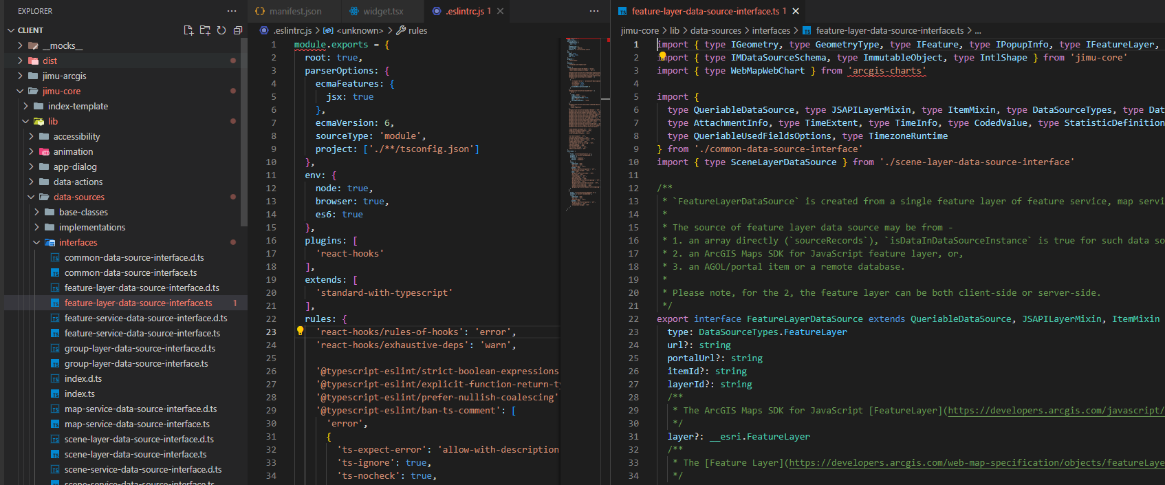

I am following this tutorial on the developers guide for ArcGIS Experience Builder. It seems like the ESLint or TS configuration that come with the download package may not be set correctly. As soon as I add the new widget mentioned in the tutorial and create widget.tsx and copy the corresponding code, I keep getting multiple TS/ESLint errors such as "strings must use single quotes", etc.. I'd assume the .eslintrc.js and tsconfig.json that come with the download package would be consistent/compatible with the tutorials. Am I missing something? I am seeing errors even in the .eslintrc.js file and jimu-core folder.

You are absolutely correct.  The rules for TS Lint and ES Lint may have changed, but a lot of library code related to jimu for example have not been updated in the new releases.  I find I often have to add those library folders to ignore paths to keep it from checking, but both webstorm and visual studio (I don't know about VSCode) seem to sometimes still report them regardless.
In webstorm, I have found it useful to look for these red lines, click on the line, then click the red LIghtbulb and fix eslint for the file.   I do find I am at times updating my eslint rules though to make some of these go away.  I agree it makes for a rough start for new dev projects as you may have to spend minutes or hours fixing all these issues before you have a clean client and server to build with.

VS Code also has the same capability of suggesting fixes for errors, but only some of those actually work.
