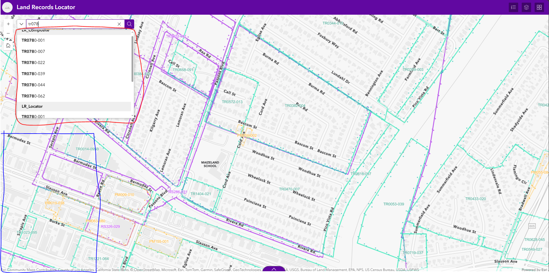

Hello,
I am trying to create and Experience Builder app where the search results show up on the left side of the web app, rather than underneath the search widget. Has anyone had any experience doing this? I've included a screenshot of what I am trying to accomplish. I'm trying to move the red area to the blue area. I appreciate the help in advance!
Thanks!

Hi @dhan ,
When using the Search widget with “Add custom search sources”, you can choose to redirect search results to a non-modal window under the General search options > Search result section. This provides a similar effect to the standard result list, but there are a couple of limitations to be aware of:
  1. No maximum record count setting for output data sources – This means if you have multiple locator sources, using separate list widgets for each one may lead to overly long result displays. While a Table widget with multiple sheets can handle this, it may not be as intuitive for users.
  2. No built-in way to close the window when the search is cleared – At the moment, the window will remain open even after the search is cleared.
Regards,
Shengdi

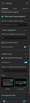

Thanks for your help. I see the General Search options > Search result section, but don't see an option to redirect the results? Do you mean that I'd have to add a list widget that pulls the results?
Here's what I'm seeing:
ShengdiZhang
Hi, you should be able to see that option if you disable the Result panel.
