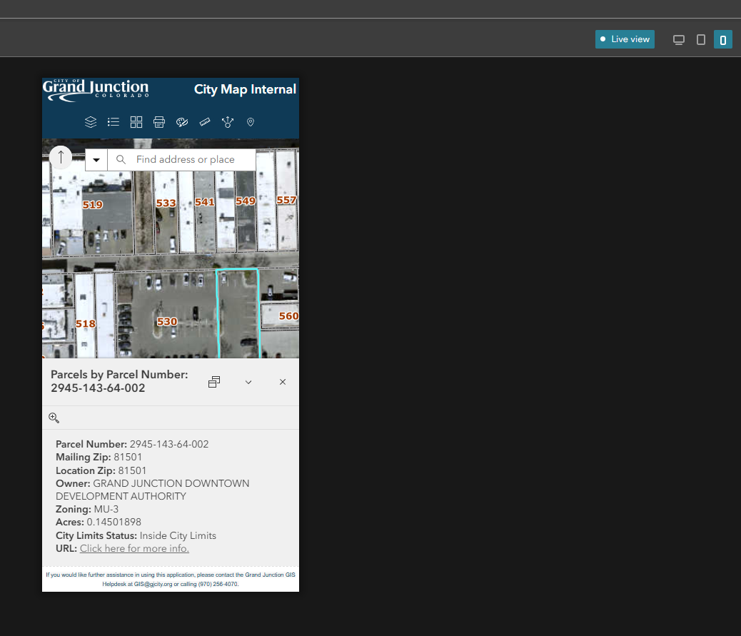

Experiencing an issue where pop ups in the the mobile viewer in Developer Edition show correctly by being over map elements such as scale bar, zoom in / out etc. as in the image below.

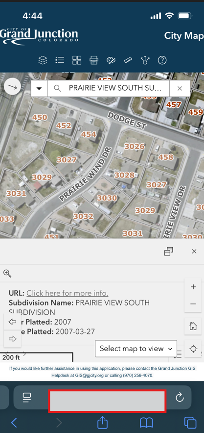

When viewing the application on an iPhone 14, map elements such as zoom in / out, scale bar, etc. are on top of the pop up. Any ideas or workarounds for this issue?

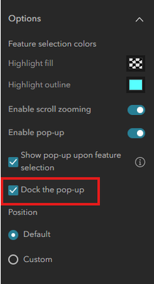

Figured it out, for phone viewer I had to duplicate the widget, move the original to the pending list, and then enable the "Dock the pop-up" option.

Hi @Brian_McLeer
I will let you know as soon as it is fixed.
BUG-000175443 When opening ArcGIS Experience Builder in an iOS browser, the Map widget tools will appear in front of the pop-up.
Thanks,
Ke
