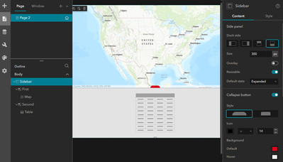

Hey all,
I just started using experience builder and posted a dashboard out to our internal users. In this dashboard I have a map that consumes the top 2/3's and on the bottom 1/3rd I have2 views that users can toggle between in order to view data tables. I have been asked if it is possible to allow users to minimize the views on the bottom 1/3rd to view the map "fullscreen". So far I haven't had any luck finding a method for accomplishing this. Any ideas? Is this possible?
As a temporary measure I have added the fullscreen button, but this consumes the full screen rather than the screen within the browser window in the way minimizing the views would do.
JenniferAcunto
Use a sidebar widget and set the panel placement to the bottom. Drop a map in the first section and your table in the second section.
- Jen
