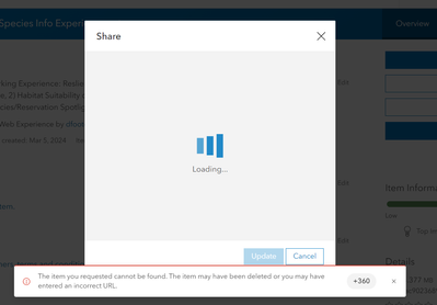

I have made a copy of the dashboard using the save as command and when I try to share it out I get this message:
It counts up to 818 and then just sits and eventually the Chrome window gets the "Not enough memory to open this page" message, with Error code: Out of Memory.
