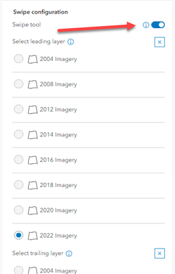

Yes, I have 8 different years of overhead imagery in one web map (and some landbase layers).
I create an Image Viewer instant app and select the multi imagery web map as the input.
Then, in the config, I turn on the swipe tool, select which imagery I want on each side (I chose horizontal layout) of the slider:
Then open the Instant App.  Can toggle layers on/off, pan/zoom, etc. just like any other webmap, but, open the swipe tool, choose which layer you want on the right vs left, and you will see it update as you move the slider.

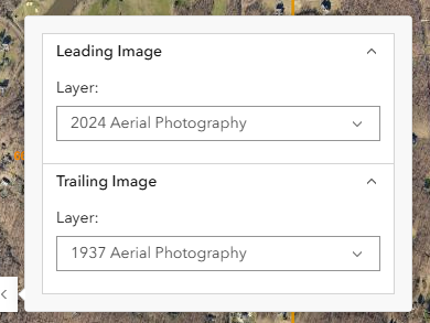

Good evening,
I am fiddling around with the Image View instant application.  I have two groups of layers in my web map, one group is aerial photography, and the other is landuse land cover data.  All are consumed in the web map as services from an outside source (Delaware's FirstMap).  I can see the two groups in the instant application image viewer tool, but when I click the drop-down arrows to select the leading and trailing images, nothing shows.  I moved two layers outside of the group, and still nothing shows in the selector.
Do you know if the application honors groups in web maps?  Is there any good help material online for configuring this application?

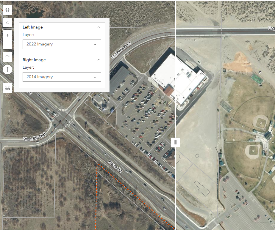

This post was very helpful as I find Experience Builder's swipe widget a confusing interface for the end user. Were you able to enter Left Image/Right Image text somewhere? I seem to be stuck with Leading Image/Trailing Image
This very simple functionality in Experience Builder ending up looking like this:
RhettZufelt
MVP Notable Contributor
It appears as if the Left/Right image was changed with ESRI's template.
My Left/Right Image Viewer app is in Portal 10.9.1.  If I build it in AGOL, I get the Leading/Trailing as well.
I even tried cloning my Left/Right Portal App to AGOL, and it is successful, but still changes the test to Leading/Trailing layers when you view it.
