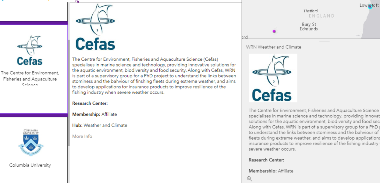

Thank you for the reply. I have a map with simple point symbols. I have a feature list linked to the map to the left of it. If I click on a feature in the list the map zooms to that point...great.
FeatureListandMap1
However if I click on a point symbol on the map, a different symbol, the feature list does not update to show the information of the symbol. The feature information in the map does yes, but not the feature list that I first clicked.....I've attached an image for reference...
FeatureListandMap2
If you look at FeatureListandMap1 you will see that all content matches. As I have clicked on the feature list on the far left to zoom to the point in the map.
If you look at FeatureListandMap2 you will see I have panned in the map to another symbol and clicked on that symbol, but the feature list on the left does not update.
So how do you link the symbol point in the map to update the feature list widget on the left ?

DavidMartinez
Ok, it looks like the selected state is off for the list if it isn't updating. If you go to content-->states-->selected make sure that is on. If this isn’t the solution, I would check your page size for the records for your feature layer under the data tab. By default it is at 100 records, so if you have a lot more features than 100 I would increase it to the amount of records in your feature layer. This will ensure your list displays the record selected when a point is clicked on the map.

Dunn_Jeremy
Morning David,
Unfortunately I only have 25 records in this list. And the selected features are "On", still does not update. What is odd is that I have another map with another list associated with it and this does respond in the way you suggest it should. So I'm stumped as these two respective maps and lists are set up the same way.
