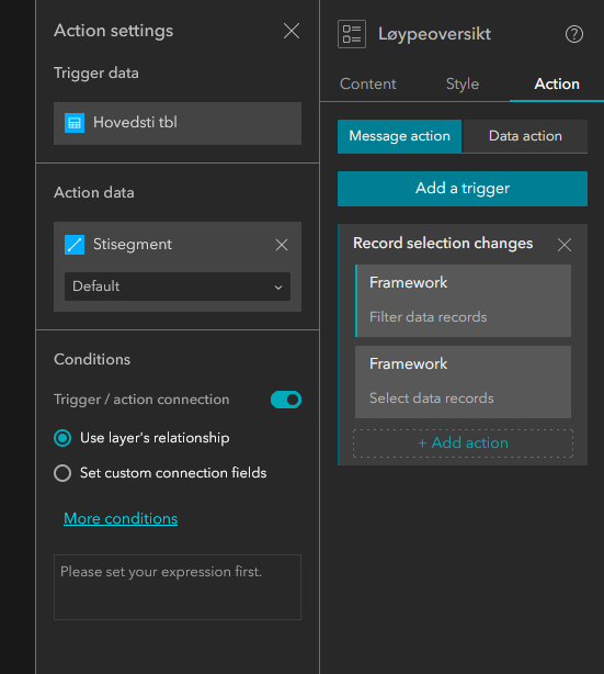

SveinungBertnesRåheim
I think this works! When you set the message action, you previously had to define the relationship. Now you can choose "Use layers relationship".
You can filter and select the result. THis does what I want:
  • I click a row in a list (name of walking routes).
  • The segments related to this route are filtered and selected in the map.
What I cannot do so far, is to find a way to automatically zoom to the filtered / selected features. This is confusing, but the action "zoom to" is not available in with this relationship. I could add the select-widget and zoom to the selected feature(s), but that makes this more complex than I want it to be. Any suggestions on this topic?
I am still not satisfied. With the new functionality, I can select a row and filter/select features in my map. But I can't find a way to zoom to or pan to theese features. The message action "zoom to" is not available with this setup. Should be possible? I want people to be taken to my selected/filtered features. Maybe @ShengdiZhang know if this is possible or not?
