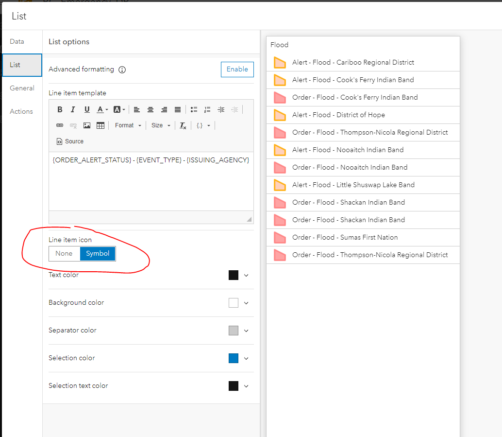

 I would like to add the symbol automatically for each item in the list widget in ArcGIS Experience Builder. However, I can not find the function in ArcGIS Experience Builder. While the symbol icon for the list exists at ArcGIS Dashboard.
Can anybody find it for me. Thanks.

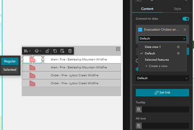

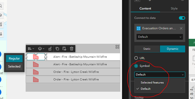

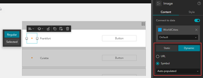

In Experience Builder, the symbol icon isn't an option in the list widget, but you can configure one with the image widget.
Please see below for the image widget settings:

Thanks Shengdi,
I added an image widget beside the text widget in a list widget, however, I could not select a specific field to set up the symbol. I would like the symbol color adjusting with the order type (alert or order) which is under the "type" field.
