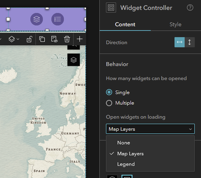

Good morning,
I don't thing you can configure the "tools" that are part of the Map widget to open by default but you could add a new Widget Controller widget to the app, then add the Legend widget to it. You can then configure a widget to open on load.
Does that get you what you need?
Jill

Marokapara
That's a good idea. Thanks.
