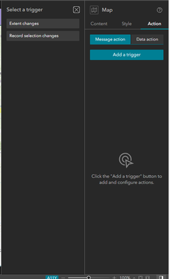

Have you tried using actions?
If you are selecting features in one widget, be it the table, or another, you should be able to go to the action's pane and configure any selection updates, like Zoom, Pan, and Flash.  I know those are in there for a lot of the built in widgets:
https://doc.arcgis.com/en/experience-builder/latest/configure-widgets/action-triggers.htm
Whether you are doing the selection on the Map
or in the table you should have an option like this.:
