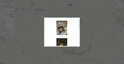

Yeah, I work with a gully dataset that currently has 41k inspection records with attached photos (proof of inspection). In ExpB the user can select a feature then click on an "inspect" icon that opens the related table with the attachments. The photos are show, along with a hyperlink. The videos can be created and managed in same way.

The attachments in the attribute table will allow more than one attachment and show up in the viewer as such after you publish the service.
The video you will add as a hyperlink in a attribute table field and I think the video will default to opening with whatever the end user has configured as their media player.  You will have to test this.
