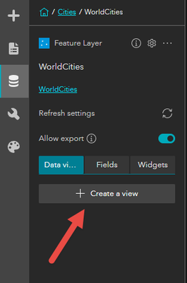

Hi @jenmac18 ,
You can create two data views from one data layer, and use them in the two list widgets.
