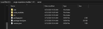

When attempting to import apps from the prior version, I do not see a server/public/apps folder in the newly downloaded experience builder (v. 1.14).
JeffreyThompson2
MVP Frequent Contributor
Try starting your server and client and logging in on localhost to see if that makes the folders. If not, try making the folders manually.
GIS Developer
City of Arlington, Texas
JaredPilbeam2
MVP Alum
Simply starting the server in both folders then logging in made no difference. I even cleared browsing history and password cache, then logged in with same client-ID-- still no apps folder. Making the folders manually did it, though! Thanks.
