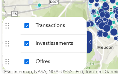

Her is the rendering on my first screen :
It's very nice.

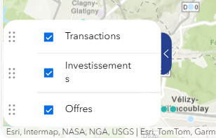

And here is the screen on my second screen (more larger) :
Holy S. my text jump and the reduce button moved. WHY ???
What I have to do to make this coherent when the screen size changed ?

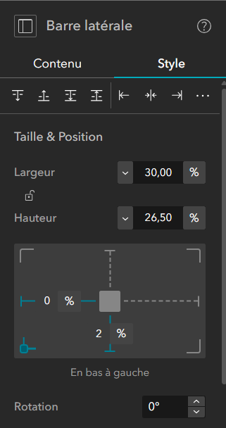

Here is the screen of my settings :
JasonBOCQUET_3-1751292126476.pngJasonBOCQUET_4-1751292139383.pngJasonBOCQUET_5-1751292148992.pngJasonBOCQUET_6-1751292155266.png
