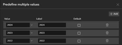

To get the count once you've filtered, the dynamic text set up above should respond to the filter since the filter automatically works with the framework. I would double-check your filter. I happen to have a similar filter where a user selects a year from a pre-defined list, using the "contains" operator for the year:
In my case, I've got a text field with years separated by commas (e.g., "2024, 2023, 2018, 2011"), but I think the contains operator should work with an actual date field too.
