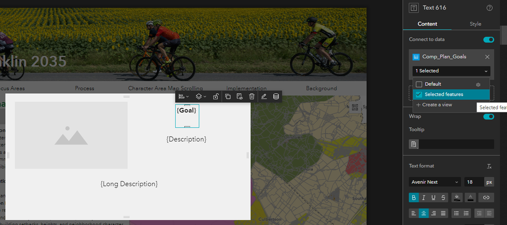

I literally just figured this out yesterday!
I had a list was based off of a data source.  I created a window connected to the data that had the dynamic fields from the same data source as the list.  I then had the window set to display the selected features from the list/data source.
