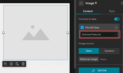

Hi @EricEscobar ,
The sample app doesn't link buttons to different views, but to one view that displays selected records (features are selected by the list widget).
You can simply put a feature info widget in the view and it will automatically switch to the selected feature. Alternatively, you can add text and image widgets and choose selected features view for them.

Thank you Shengdi!  I see what I was doing wrong.  I was doing exactly that, trying to link the buttons to different views.  I tried the feature info widget before and, it wasn't working for me.  But, after looking at your screen capture, I noticed that I never connected my data (this shows how novice I am).  Thank you once again!  This truly helped.
