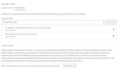

AzizaParveen1
In my last response, the link I shared is a bit old for creating attribute index. Here is the updated doc on how to create attribute index in hosted feature layer. you need to be the owner of the layer or you need administrator role in your org.
https://doc.arcgis.com/en/arcgis-online/manage-data/manage-hosted-feature-layers.htm#ESRI_SECTION1_0...
