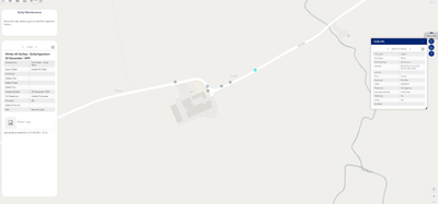

The screenshot is of an exp that's embedded in a Roads exp - it shows the gully, you'll see it's showing 2 inspections along with the attachments, I can click the widget controller to view the Parent Feature etc etc.

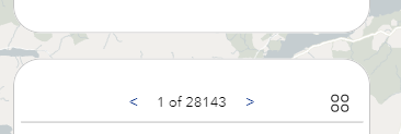

Then this is the number of inspections held 2020/21
