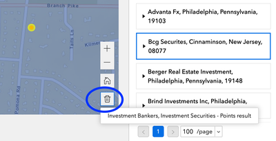

Maybe you can try using this to clear the 'Show on map' added features
