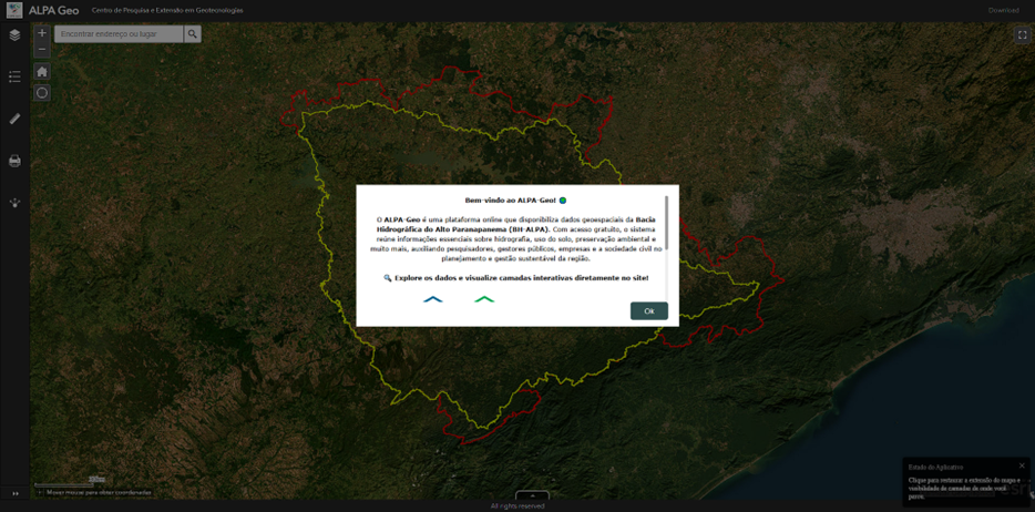

Hello everyone,
I previously created a Web Map using the Web AppBuilder, where a pop-up message would appear when users opened the app, displaying a welcome text that explained the project.
Recently, I had to migrate my project to the Experience Builder, and I would like to include the same type of welcome message (for example, a modal or pop-up window that appears when the app loads, with a short introduction about the project).
Could someone please tell me if there is a built-in way to do this in Experience Builder, or if I need to use a custom widget to make it work?
Thank you in advance for your help!
(Attached are screenshots showing the pop-up message from my previous Web AppBuilder project and the new Experience Builder version)
FelipeSteidle
AustinAverill
You would want to create a new Fixed Window and select the "Set as Splash" option when hovering over the window.
