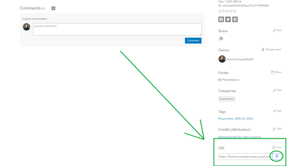

Kara_Shindle
I do this a fair amount - side benefit is you can track who looks at the PDF.
1. Upload the PDF as an item to AGOL
2. Adjust your sharing levels
3. Go to the item page for the PDF & copy the URL that should be at the lower right corner of the overview page.
4. Go to your experience builder & card widget.  There are several link options depending on the card widget template you chose.  You can set the link to open a URL & then paste in your PDF URL.

SanchezNuñez
Hi @Kara_Shindle
In AGOL I do not see any  "URL that should be at the lower right corner of the overview page.". The default one from the top does not work when I add it to EB.
Kara_Shindle
When I upload a PDF to AGOL - at the bottom right corner of the Item Overview page is a URL that you can copy.
ElisseDeleissegues1
I also am not seeing the URL
ElisseDeleissegues1
I was not seeing the URL either, when the Sharing option was made Public the URL appeared.
SanchezNuñez
Thank you @Kara_Shindle, the field URL is not visible in my AGOL.
