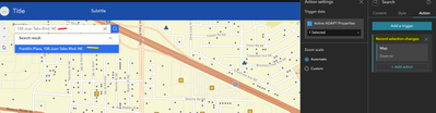

You have to set up a an action to zoom when the selection changes and it somewhat depends what you are searching (layer or using a locator) - in the first screen shot below, i set up a action this way so when i type in my target (see the red mark in the search box), then it gives me the search result (yellow mark) I can click on that to select the record and it zooms to the selected record - this is with the search source set to layer where I'm only searching for features in a specific layer and specific fields within that layer.

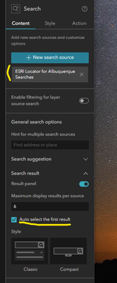

The second screen shot below shows how to set up the search using a locator - in this case I've checked the 'auto select first result' which then automatically selects my location and zooms to it.
Heather_Hegi
Thank you very much! I was overlooking the action settings to choose the map.
