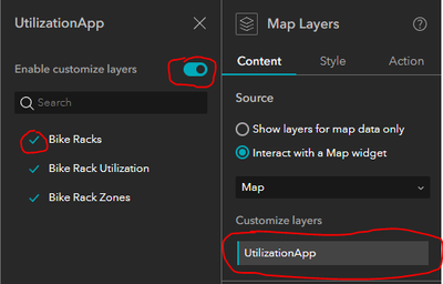

JoshuaReyling
If you select the layers widget in the Wxb editor, there is now an option to 'customize layers'.  selecting this pops out a new pane which will let you edit the visible layers in the widget.  This has no effect on the layer visibility on the map, but it can disallow the toggling of visibility:JoshuaReyling_1-1690989474301.png
Hope that helps!

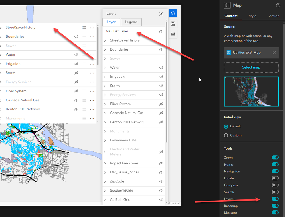

lzk222
Thanks, this is part of the solution. Note that what I'm speaking to is a little different. The difference is that the standalone layers widget is unlike the "tools" layer widget in terms of access and customization. My critique is that the "tools" widgets don't allow users the ability any level of customization (as is shown in your screenshot, JoshuaReyling)
.The solution to my use case is to, in fact...
  • Add the layers list widget again (as standalone)
  • Enable the customizable layers function (as shown in this thread)
  • Uncheck the wanted layers
  • Hide the standalone widget behind the map (this part was a little tricky, but some trial and error achieved the desired result).
A somewhat convoluted process, but it works. Apparently, the standalone widgets interact with the "tools" widget on the backend...wouldn't be surprised if this is some kind of happy accident that ESRI engineers aren't even aware of.
Overall, I think it would be a significant improvement if  the devs could simply build in customization access for the "tools" versions of these widgets.
RhettZufelt
MVP Notable Contributor
@lzk222 Is this still working for you?
I am having issues trying to hide a layer in the layers tool rather than the layer widget.
However, before struggling to figure out how to 'hide' the layer list widget, It looks like the settings are not transferring over to the tool.
Curious if this is still working for you, or if you have found a new way to hide a layer in the built in layer tool
Really like the layer tool as it doesn't need a wiget, doesn't take up space until opened, and, has a legend in it as well.
I do see that the legend part honors the don't show in legend in the web map.
Thanks for any input,
R_
